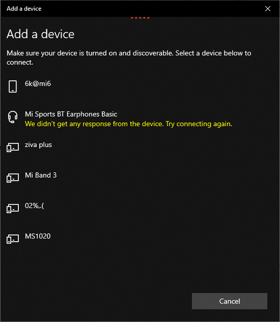

The Bluetooth feature on Windows 10 is unable to establish a connection with any device. An error message indicates that there was no response received from the device.

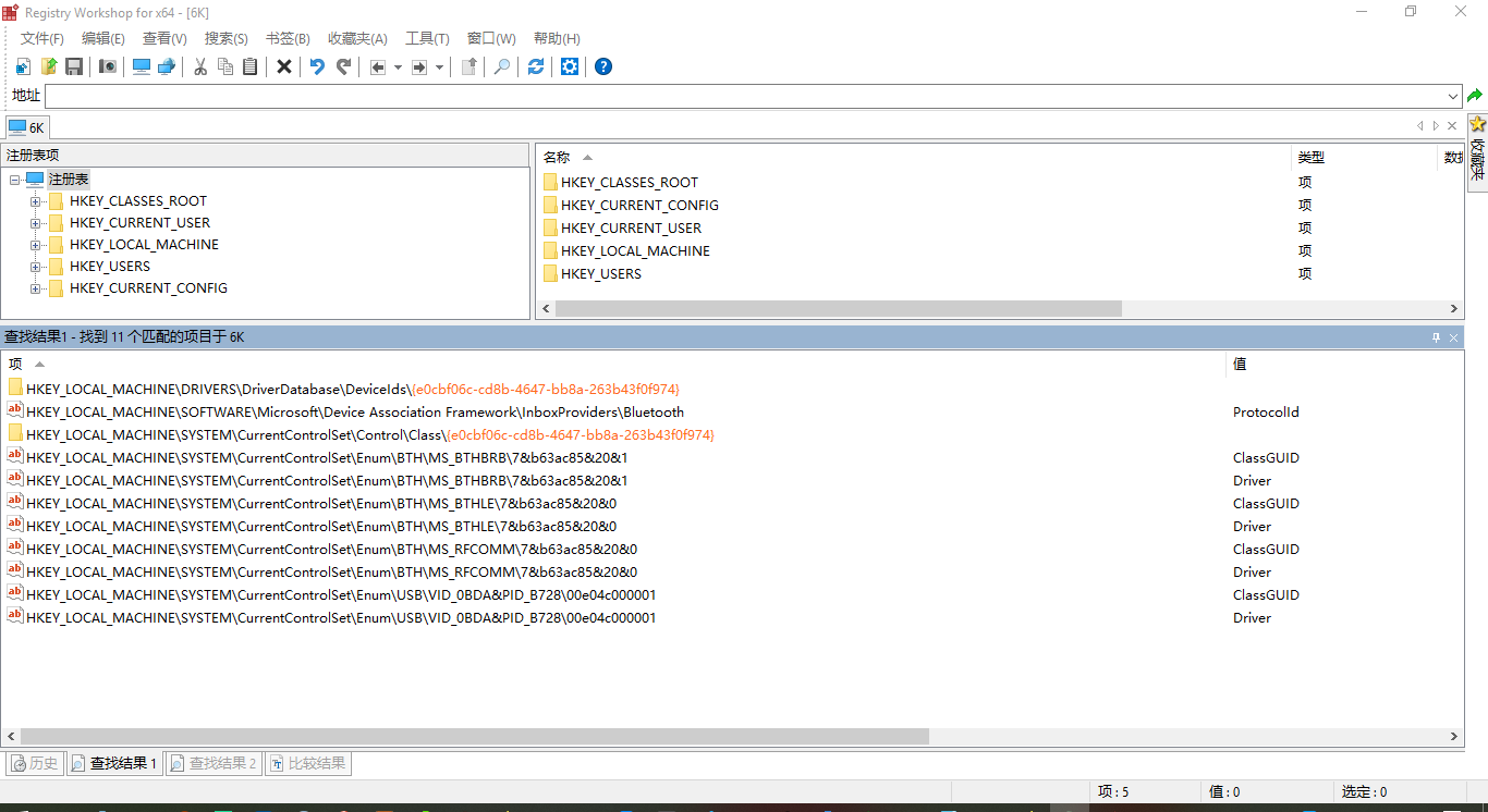

Therefore, I resolved to fix the problem by modifying the registry on the old system. I looked up the class ID of the Bluetooth hardware in the device manager and queried the registry values associated with the old and new systems, which solved the issue.
Information: Registry
Information: The class ID of the Bluetooth hardware
Would anyone be able to provide me with some recommendations for resolving this issue? I would greatly appreciate it.
Bluetooth is a wireless technology that allows communication between devices over short distances. It is commonly used to connect devices such as headphones, speakers, and keyboards to a computer or mobile device. However, sometimes Windows 10 Bluetooth can’t connect to any device, and users may encounter an error message that says, “Didn’t get any response from the device.” In this blog post, we will discuss some solutions to this problem.

Modify the Registry
If none of the previous solutions worked, it may be necessary to modify the registry to fix the problem. However, it is important to be careful when modifying the registry, as it can cause serious problems if done incorrectly. Here are the steps to follow:
- Press the Windows key + R to open the Run dialog box.
- Type “regedit” and press Enter.
- Navigate to the following key: HKEY_LOCAL_MACHINESYSTEMCurrentControlSetControlClass{e0cbf06c-cd8b-4647-bb8a-263b43f0f974}
- Look for the “UpperFilters” value in the right-hand pane and delete it.
- Restart your computer.
After your computer has restarted, try connecting your Bluetooth device again and see if the problem is resolved.
