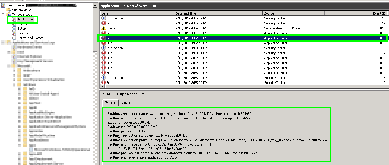

The issue is that some Provisioned Windows applications on Windows 1903 are not working properly as they open briefly and disappear. To troubleshoot this problem, you can check the Application logs in the Event Viewer and look for Event ID 1000 events.

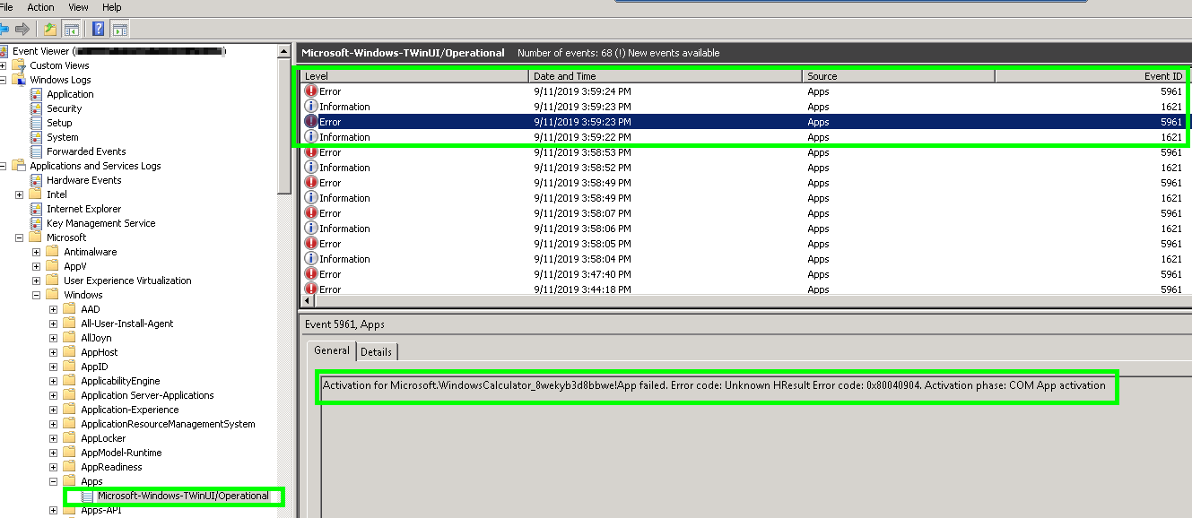

Another option is to examine the Microsoft-Windows-TWinUI/Operational log within the Event Viewer | Application and Services Logs | Microsoft | Windows | Apps, where you may find Event ID 5961 events recorded.

- Event ID: 1000: Exception code: 0xc000027b
 - Event ID: 5961: Error code: Unknown HResult Error code: 0x80040904. Activation phase: COM App activation

Event ID 1000
Faulting application name: Calculator.exe, version: 10.1812.1901.4008, time stamp: 0x5c304989 Faulting module name: Windows.UI.Xaml.dll, version: 10.0.18362.356, time stamp: 0x0825b5b0 Exception code: 0xc000027b Fault offset: 0x0000000000712cf0 Faulting process id: 0x1518 Faulting application start time: 0x01d568dbe3b0f42c Faulting application path: C:\Program Files\WindowsApps\Microsoft.WindowsCalculator_10.1812.10048.0_x64__8wekyb3d8bbwe\Calculator.exe Faulting module path: C:\Windows\System32\Windows.UI.Xaml.dll Report Id: 23d86f95-8eec-407b-b52c-86043d6d0426 Faulting package full name: Microsoft.WindowsCalculator_10.1812.10048.0_x64__8wekyb3d8bbwe Faulting package-relative application ID: App
Event ID 5961
Activation for Microsoft.WindowsCalculator_8wekyb3d8bbwe!App failed. Error code: Unknown HResult Error code: 0x80040904. Activation phase: COM App activation
