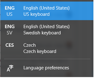

By default, both US English and Swedish keyboard input methods were installed on my work laptop, and I added Czech later. However, the Swedish layout keeps appearing on its own, and I am unsure why. I want to completely remove the Swedish input method as I only require US English and Czech layouts.
Unfortunately, I have been unable to locate the Swedish layout in the settings panel, despite checking several places such as the language switching panel where it appears under the “English (United States)” option. This task has proven to be more difficult than expected.

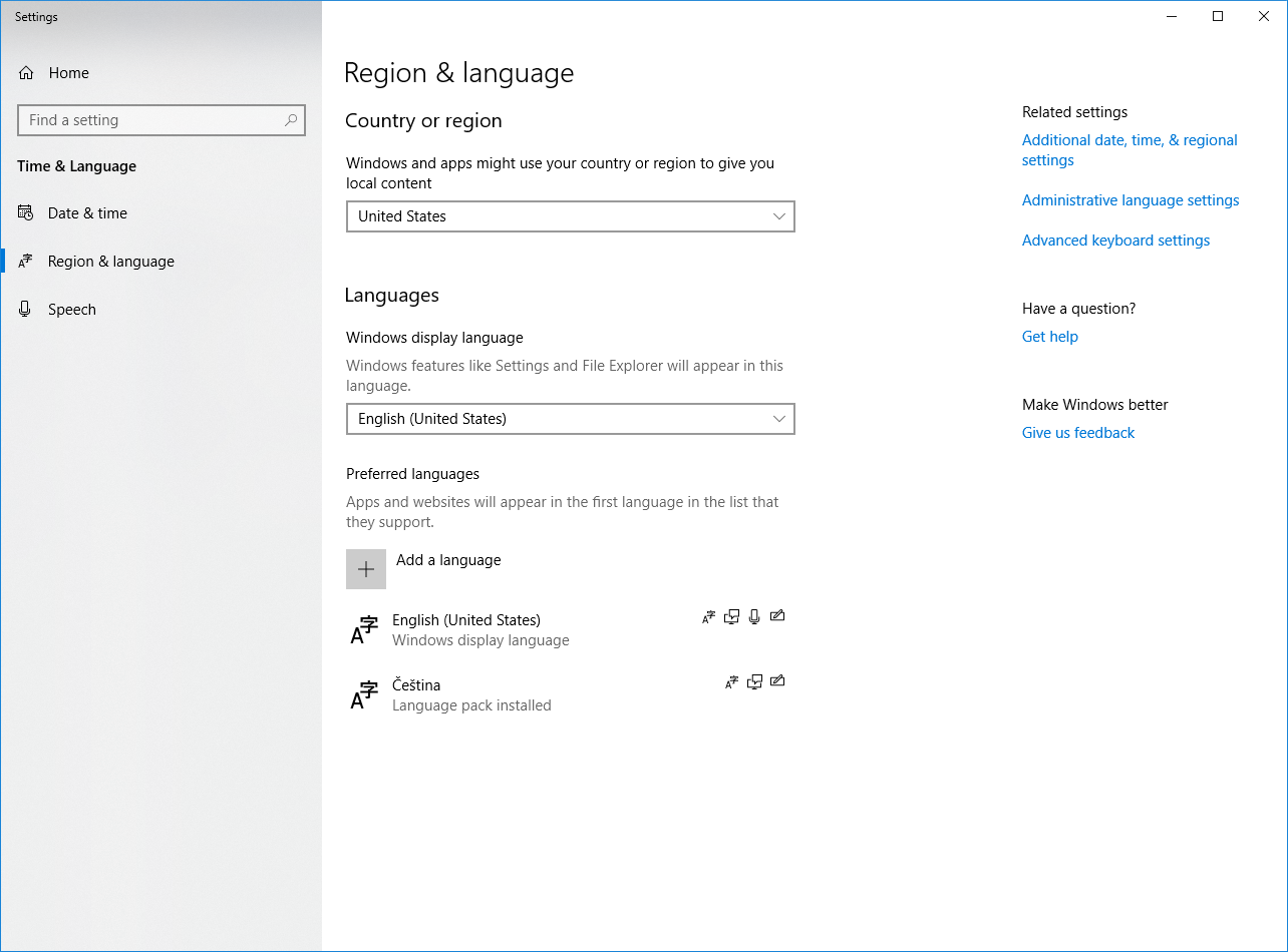

There’s no reference to Swedish under the “Region & language” options:

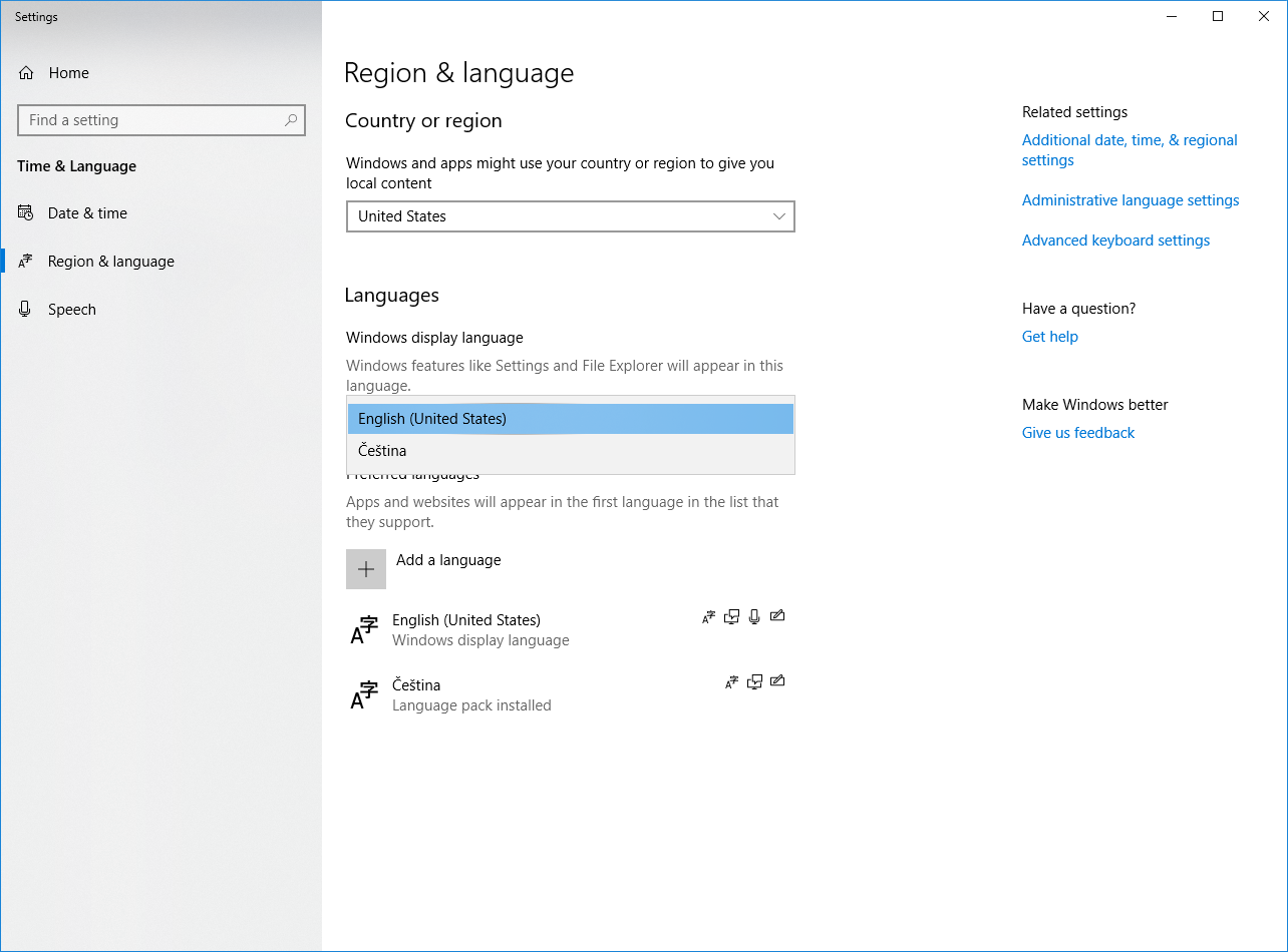

Just in case it’s not clear – Swedish isn’t selectable under “Windows display language”.
And underneath the “English” display language on that same page, Swedish isn’t mentioned at all.

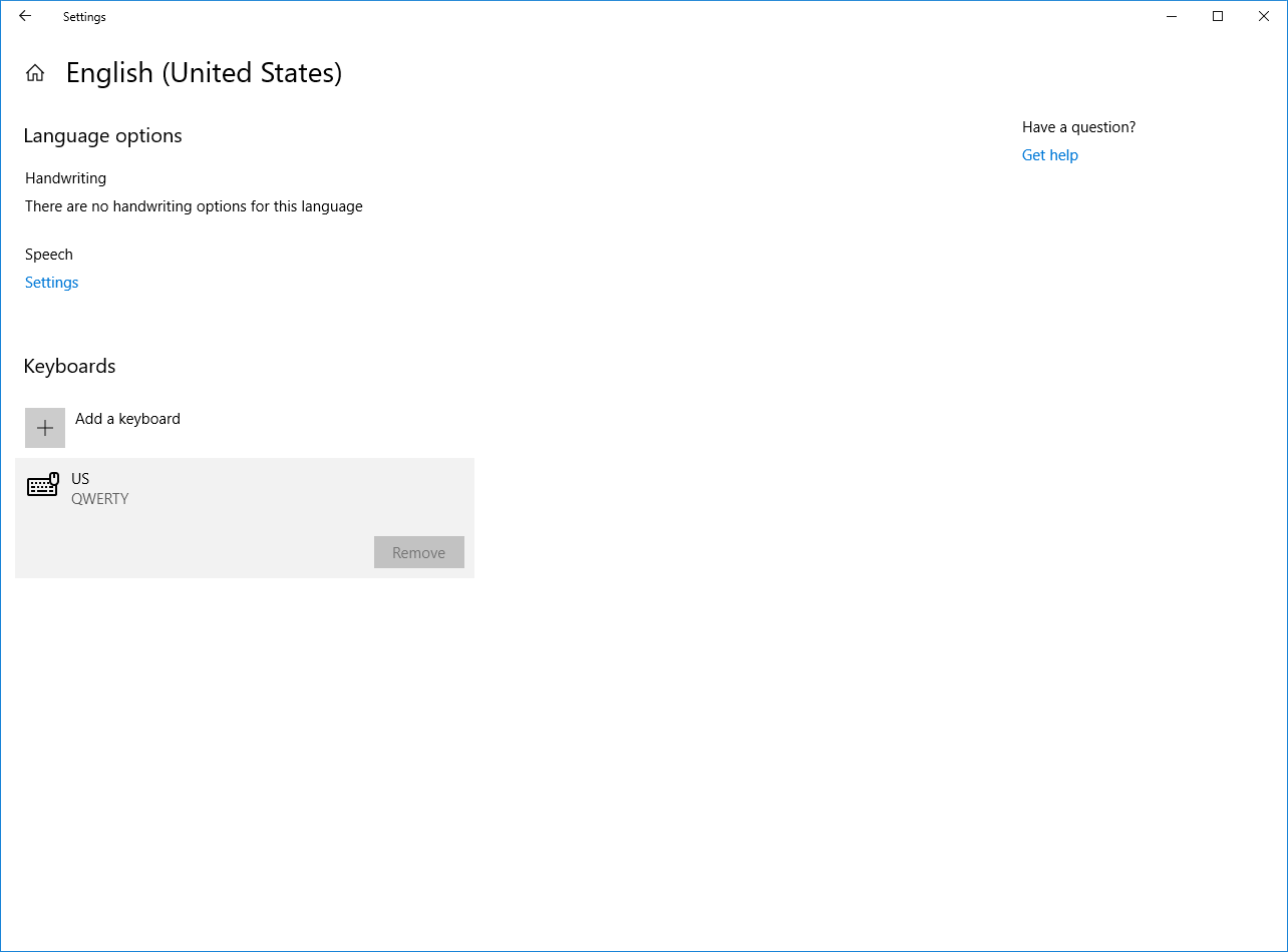

I have searched through the Control Panel and Settings but have not found any indication of the Swedish input method. I am hoping someone might have insight into where I can locate and remove it.

Although I was unable to completely remove the Swedish input method, I have found a way to lessen the impact it was having. It was causing the input methods to switch at random, which was happening because of a keyboard combination (perhaps Ctrl + Shift) that was triggered while coding.
To prevent this, I clicked on the language switcher in the task tray and chose “Language preferences”. In the next window, I selected “Region & language”, then “Advanced keyboard settings”, and finally “Language bar options”.
This opened an older-style Windows settings dialog called “Text Services and Input Languages” with two tabs. I then went to the “Advanced Key Settings” tab, where I found a table that allowed me to enter a key sequence to perform different actions. I clicked on “Change key sequence” for each action and selected “Not assigned”.
