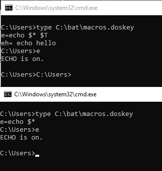

I have created a permanent doskey using a macro file, but whenever I use a command from the list, the current working directory is printed twice in the top terminal.
This issue seems to be related to the use of $T
in the macro file. The bottom terminal in the picture shows that everything works fine when the macro file only contains one doskey alias. What can I do to solve this problem?

The previous discussion is inaccurate, and using the $T
token at the end of a DOSKEY macro is incorrect. The $T
token serves as a command separator within a single DOSKEY macro definition, and not as a separator between multiple definitions. A regular line break is sufficient for the latter purpose.
DOSKEY macros function by modifying input before it is sent to the actual program (Cmd). Each $T
in the macro becomes a line break or Enter key press in the expanded output. For instance, if you typed “e Hello!
“, the macro “e=echo $
” would generate “echo Hello!↵
“, “e=echo $
$T
” would produce “echo Hello! ↵↵
“, and “e=echo $* $T echo Bye!
” would yield “echo Hello! ↵ echo Bye!↵
While creating DOSKEY macros for Cmd, the standard &
or &&
operators can be used as a command separator. However, these operators are not available in other interactive programs, such as Netsh or the MySQL interactive client, which only allow one command per line. Hence, DOSKEY macros require the $T
token to send multiple commands at once.
