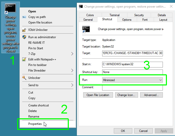

For Windows 10 64-bit, here’s how to create a one-line shortcut or cmd batch file to modify power settings (display timeout, sleep timeout, hard disk timeout, etc.), launch any program, and restore the original power settings when the program is closed.
The power timeouts range from 1 minute to 9999999 minutes, and the most common AC/DC power settings are provided. Instead of a batch file, a Windows shortcut can be used.
A default sleep timeout of 30 minutes is preferred, and the shortcut can be initiated in a minimized state. The path to the program should be adjusted accordingly. The shortcut can be executed with or without admin privileges.
It is not recommended to launch the program with this syntax: start “” “C:\Program Files (x86)\Microsoft Office\OFFICE11\WINWORD.EXE.lnk”. This applies to desktop computers.
A picture demonstrating the minimized state is provided at the bottom:
C:\Windows\System32\cmd.exe /c POWERCFG /CHANGE /STANDBY-TIMEOUT-AC 1440 &"C:\Program Files (x86)\Microsoft Office\OFFICE11\WINWORD.EXE" &POWERCFG /CHANGE /STANDBY-TIMEOUT-AC 30

Run minimized:
