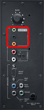

In case you possess stereo mini-jacks that are enclosed by green, black, and orange surrounds, you can make them work for a 5.1 system by using suitable cables. Simply connect these cables to the ports located on the back of the subwoofer.
It’s an uncomplicated process that involves matching colors. The Logitech Z506 system solely supports 6-channel analog input and doesn’t offer any other input options such as USB or S/PDIF, meaning you may require a “translator” to use these types of input. To keep things simple, you will need to make use of those three colored ports. In case these ports aren’t available on your motherboard, you can purchase a USB break-out box starting from around $£€5 on eBay. When searching for a USB break-out box, be sure to avoid the cheapest ones that come with only two socket outputs as they won’t meet your expectations. Look for a model similar to the one shown here.
