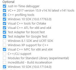

The issue is that the process crashes and in the event log, it is shown that it works on a computer with Visual Studio 2017 installed, but not on one without. I have tried installing various components, such as .NET desktop development, Desktop development with C++, Visual C++ MFC for x86 and x64 and Windows 10 SDK 10.0.17134, but to no avail.
Look the screenshot:
I have also attempted to install redistributable versions of various versions, but the problem persists. I am unsure of what is missing and what is not included by default in Windows and Microsoft Visual C++ Redistributable for Visual Studio 2017.
